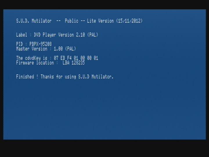

Oh, and I've another request. If possible, can you please insert your PSBBN 0.32 disc in your PS2 and run MUTILITE.ELF ?
You should see something like that :
All I need is the cdvdKey.
Thanks for your time.
