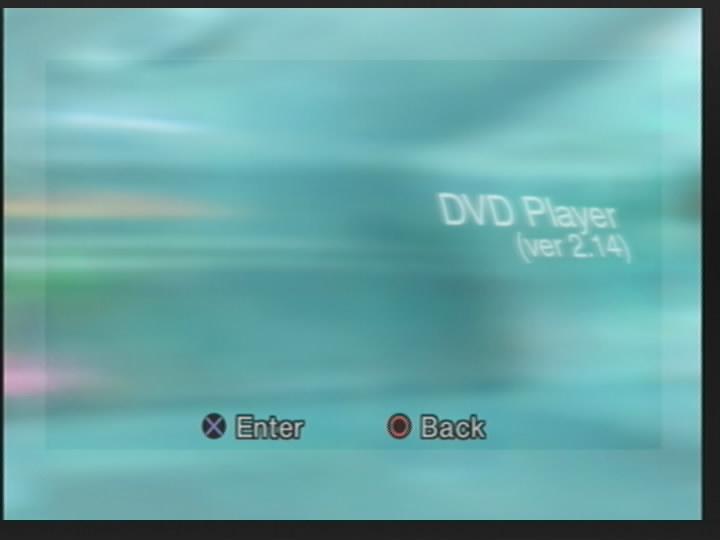

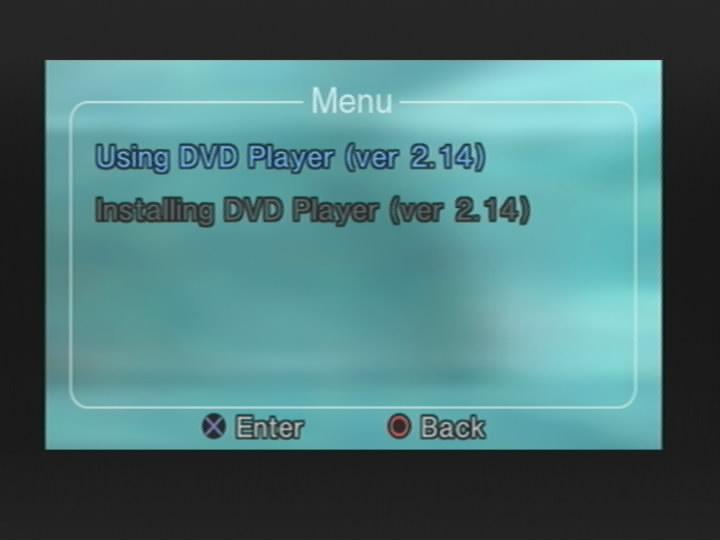

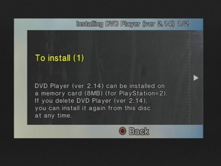

Евросоюз / European Union DVD Player Version 2.14 (PAL) [PBPX-95219]
* Hacked Build A2 *
Archive Size : ~6 MB
Disc Image Type : BIN/CUE for CDR
Size (Extracted) : ~40 MB
Hosting : Dedicated Server or Mediafire
Cracked DVD Player upgrade disc. For use only on European consoles.
